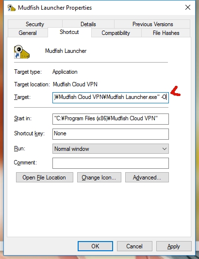

Using -O option
  • After clicking “Start” button of Windows, moves to or find “Mudfish Cloud VPN” menu.
  • Opens the property window of “Mudfish Launcher” icon by clicking the right mouse button on it.
  • Modify the command which found at “Target(T)” box that as default, the following value is set:
  • Changes the command with -O option. For example, looks like below:
  • As result, “Target(T)” would be like below:
    ../../_images/VKP1V1.jpg
  • -O option turns on a feature using IP and port of old master server.
