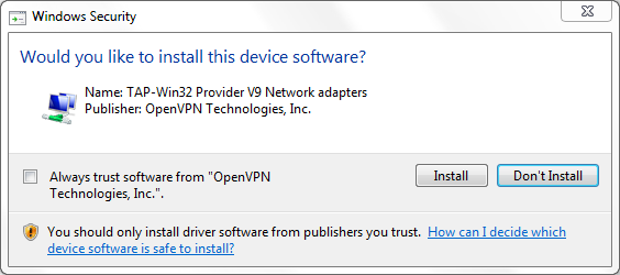

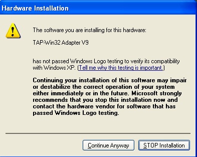

Error screen on the certificate
If it’s your first installation for Mudfish, you could encounter the following warning messages to install TAP-Win32 Adapter v9. This network driver must be installed.
If you’re a Windows 7 user, the following dialog box could come up.
Diaglog box of Windows 7
Keeps going to install.
Completed

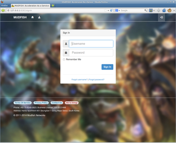

Sign in
If Mudfish Launcher is working correctly, your default browser will be launched then automatically visit the Web UI as follows:
Sign in for "Mudfish Launcher"
How to use Mudfish Launcher

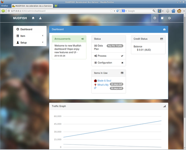

The following screen will be shown when the sign-in process was good.
"Mudfish Launcher" Dashboard
Now it’s ready to use all Mudfish nodes.

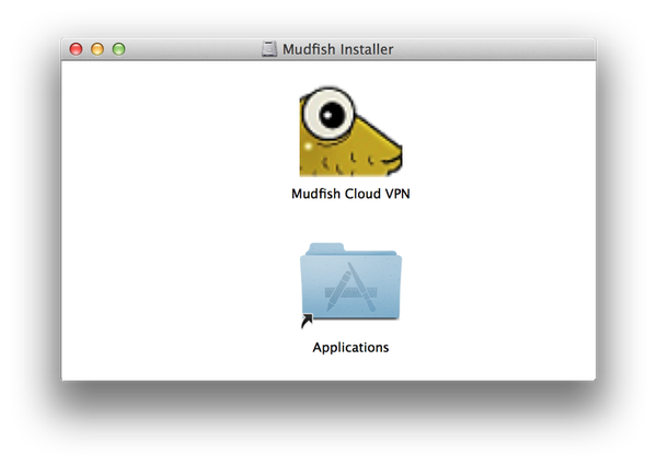

We assume that you downloaded a Mudfish package from the download page and the file extension of package is ”.dmg”. With double-clicking the file, it’ll be mounted on the OS and show the folder. You can install the Mudfish by copying the icon into Applications folder.
../../_images/macosx_installer_main.png
Like other applications, the drag-and-drop into Applications folder is all to install

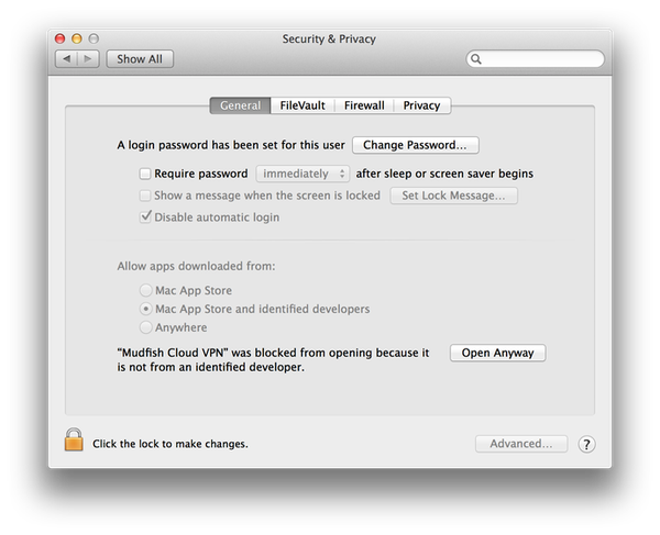

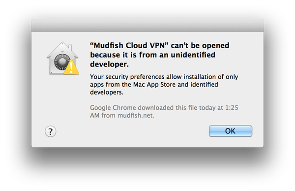

As some security reasons, running the Mudfish could be blocked with the following window:
../../_images/macosx_installer_secwarn_en.png
Then you should manually add the application at the exceptional list which is available at ‘System Preferences -> Security & Privary’ menu.
../../_images/macosx_installer_sec_en.png

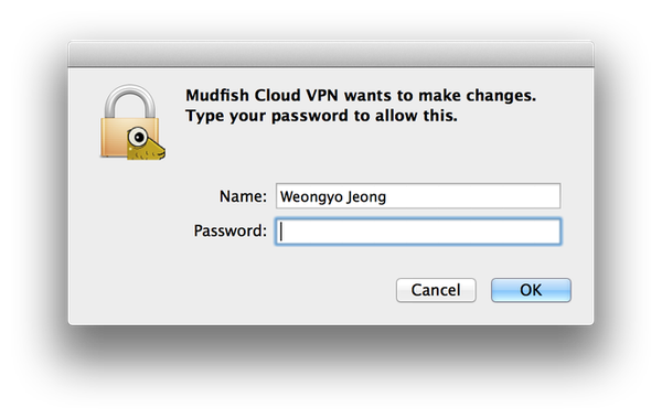

When it’s launched, it’ll ask your root’s password.

Sign in
If Mudfish Launcher is working correctly, your default browser will be launched when you click ‘Open Dashboard’ menu on the Mudfish menulet icon as follows:

Sign in
On Linux system you should manually open the browser and access to Mudfish UI which is normally available at http://127.0.0.1:8282
