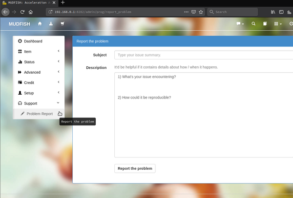

How to send¶
Automatic Mode¶
To send the problem report, first you should click the pencil icon located at top-right of Mudfish Dashboard.
Then fill information and press ‘Report the problem’. Normally it takes 2 ~ 3 minutes to submit the problem report.
When it’s successfully submitted to mudfish system, it automatically creates a “problem report” topic at Mudfish Forums. If you can’t find a topic created for it, it means there’s a unexpected problem. So you should resend it again.
