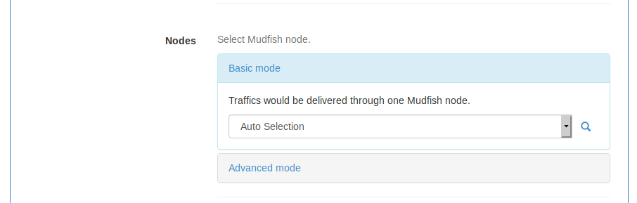

- change your node
https://mudfish.net/forums/6/topics/44662

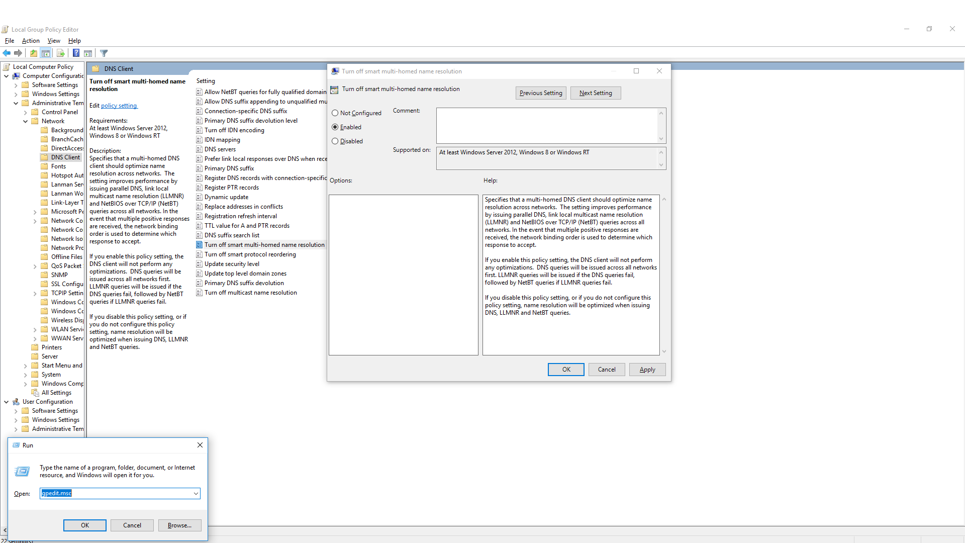

- connect with Mudfish DNS Client If Mudfish DNS Client doesn't work,

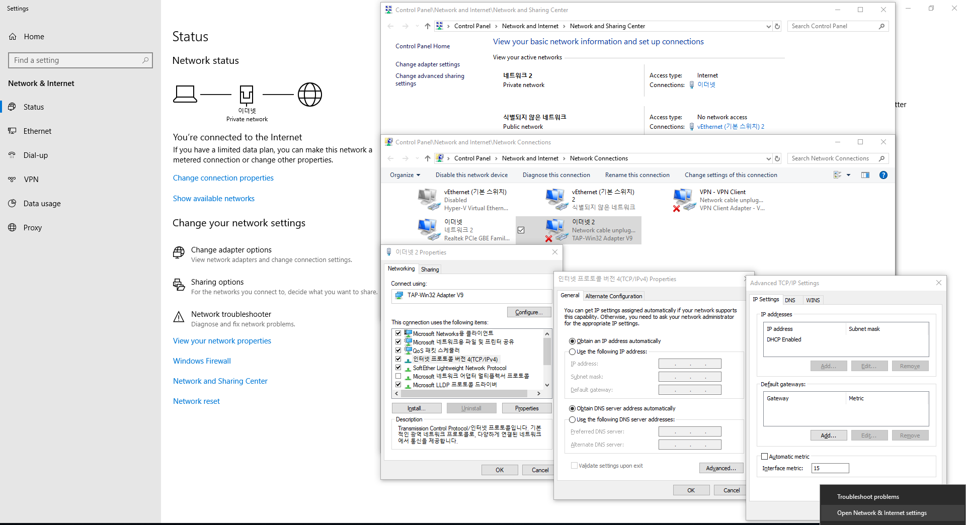

- gpedit.msc - Local Computer Policy - Computer Configuration - Administrative Template - Network - DNS Client - Turn off smart multi-homed name resolution - Enabled - OK
- Control Panel\Network and Internet\Network Connections - TAP-Win32 Adapter V9 - Internet Protocol Version 4(TCP/IPv4) Properties - General - Advanced... - IP Settings - Automatic metric - Interface metric - recommended 15
